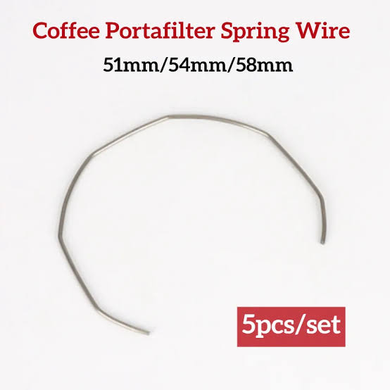

A încercat cineva să folosească un cuplaj de filet pentru a atașa un calibre în acest staresso? sau poate un cuplaj imprimat 3d cu un atașament pentru calibre.
Posts: 17.211
Wrote some thoughts on this subject here:
https://www.espressoman.ro/forum/Thread-...#pid207436
... but never tried.
Not confident that a 3D print insert would cope with high pressure and temperature.
Also, any additional space there will led to more water/mud above the puck.
Posts: 12
Joined: Sep 2024
Manila
19-09-2024, 20:27
(Edited 19-09-2024, 20:30 by abigdavid.)
(19-09-2024, 10:47)renatoa Wrote: Wrote some thoughts on this subject here:
I saw the post. Thanks for the link. I still hope for a gauge/indicator of pressure to be integrated in staresso, something like the ones they have for picopresso.
![[Image: images?q=tbn:ANd9GcRBk0DScaPhsAOFE1Z4-jA...aGsp4&s=10]](https://encrypted-tbn0.gstatic.com/images?q=tbn:ANd9GcRBk0DScaPhsAOFE1Z4-jAcdiwL9Y34Bi2VBnF9dPBi78lNt9IS3gaGsp4&s=10)
i hope we can get one for staresso or anyone tried connecting this to staresso?
