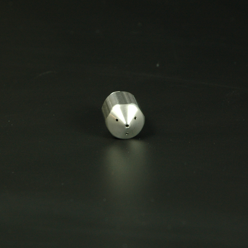

Am achizitionat saptamana trecuta, de pe Tidaka, un capat (duza?) pentru teava de abur, care are o gaura mai mare in mijloc si 3 mici, in jurul celei centrale.
Linkul aici si pretul de 23 euro.
Diferenta intre piesa asta si cea cu 3 gauri standard este uriasa, se amesteca mult mai bine laptele si e mai usor de lucrat cu latiere mici.
In alta ordine de idei, am inteles ca in versiunea noua de firmware o sa extinda preinfuzia pana la 10 secunde - vreo idee cand o sa apara aceasta versiune noua?

I've bought for cheap 2 holes steam tip with (actually) 1.0mm holes and it works fine too.
RE: Espressorul Dalla Corte STUDIO - TomaCaragiale - 23-02-2022
(23-02-2022, 17:13)PeterG Wrote: I've bought for cheap 2 holes steam tip with (actually) 1.0mm holes and it works fine too.
Good to know - I've personally struggled to get silky milk, I either put in too much air or not enough, but no fault of the machine obviously :D It's definitely been better with the new piece.
